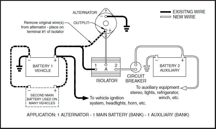

Hi Lund - unfortunately, you cannot just hook your 2nd battery up to your 1st battery, unless you want a nice acid shower underneath your hood. <img src=
In all seriousness, you need what it called a "battery isolater". Be sure to get a diode style isolator (most are), otherwise you'll need about 50 pounds of wiring and it's a pain in the butt. A normal diode-style isolator only has three posts on it, and they're pretty easy to wire up. You can get a decent one for under $40 at your local auto parts store.
They look like this: http://www.northerntool.com/webapp/wcs/stores/servlet/product_6970_200343388_200343388
Wiring them is pretty straightforward... Here's a sample diagram:

Ok thanks, so basically what I need to do is get the isolator and hook it to the altenator with the two batteries hooked to the isolator. I do have a couple questions though. What kind of advantages will I see with this setup? And what size altenator would I need? I have a stock altenator right now, so I assume its probly putting out about 65 amps.

Hi Lund - yup, they're pretty easy to wire into place!
Advantages:
1) it isolates your cranking/starting battery from your accessories battery. This way, if you drain your 2nd battery dead, because you left off-road lights on, a stereo on, etc., you won't be stranded.
2) You get extended life out of your batteries
Alternator:
Your stock alternator should be fine unless you are running excessive draws from your battery(ies). If you are running excessive draw, then you should upgrade to a 90 amp alternator.
Your stock alternator is probably either 60 amps or 65 amps.
