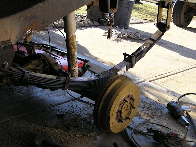

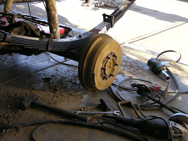

So i threw on the rear springs today. i thought that they were gonna be way to stiff but once i got them on and pushed down on them i couldnt believe how soft they were. i really perfer these over the usal 63" chevy springs these springs are i think 56" compared to like the stock 48" coorect me if i am wrong didnt take measurements. 56" puts the new front hanger right at the up cure for the rear part of the frame. the 63 just put the front hanger way to forward might be good for on the cheap but i wheel hard and like to drag my belly over shiznit so will see how this works.

I think you'll really like those springs from All Pro. The great hting about leaf springs (aside from their simplicity), is that you can still load up at least some weight in your bed and not have it sag like standard rate coils will.
Are you going spring-over-axle all the way around on your truck?
Post a few pictures on here so we can see the progress!

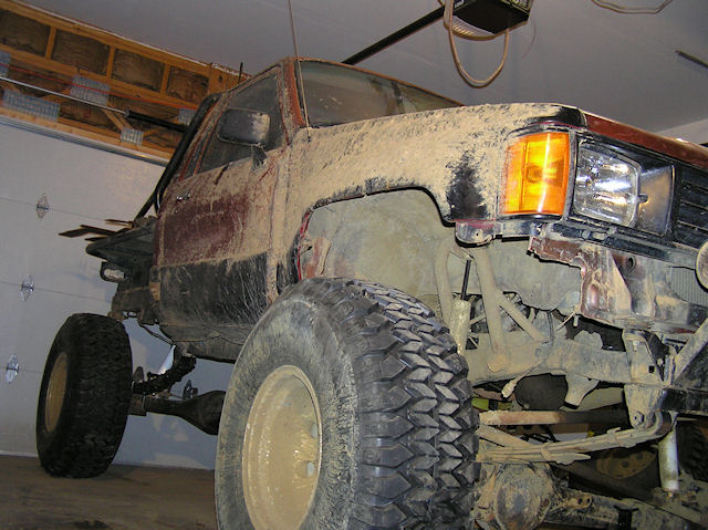

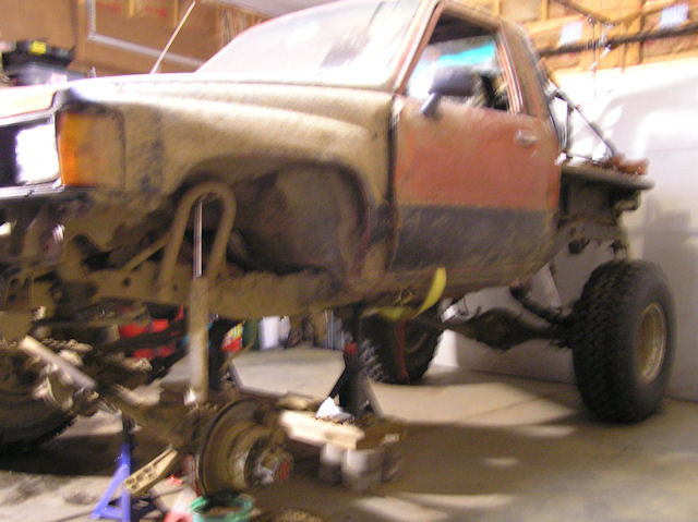

rick sheck your mail i dont know how to get the pictures on the website but i sent them to you.
MIDWEST4X4.US
webby4x4User is Online
Posts:2351
01/02/2009 12:29 PM
Danny - here's how you post photos... http://www.4x4review.com/Forums/tabid/97/forumid/46/postid/18519/view/topic/Default.aspx
I went ahead and posted them though.
It's looking REALLY good my man! Can't wait to see some more photos, and definately some action shots!

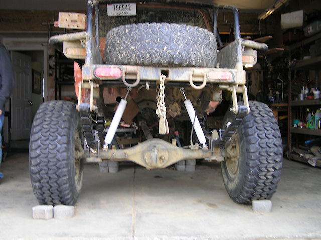

so what you think about the shock setup stole it off the old cruiser set up you had. its all in house fab work anymore. i just thionk that i might have not put enough angle on the shocks when i made the mount. heres the deminsion 10inches in on the frame mount. then i went two inches in on the axle. the shock is 30 inches long at extension. and the axle is 22 inches away from the the frame at full droop now there is gonna be down wards pressure wheh i start to flex it out so i hope it uses all of the shock lol.

Looking good, Danny!!!
As far as the shock angles go... You can't really "look" at the angles and see if they are right or wrong, it's really all about the math and taking measurements. Here's an article we did on this...
http://www.4x4review.com/Features/Tech/BeAGeniusShockAbsorbers/tabid/307/Default.aspx
In particular, read this paragraph, and the paragraph above it that shows the effective dampening rates of shocks when mounted at an angle (it changes greatly)...
How long?
Size really does matter here. It is very important that you use a shock that is the right length and has enough travel in both compression and rebound to dampen the axle it is connected to. In the easiest of all situations, the shock is mounted straight up and down. The measurement is fairly easy. Measure the distance from the suspension bump stop to surface that it makes contact with, and add a ½" for compression of the bump stop. This measurement is your compression travel. Now measure from your upper shock mounting point, to the lower mounting point. For explanation purposes, lets say that the distance from the bump stop to the contact surface is 5.5" and we add a ½" we now have 6". Lets also say that the distance from the top mounting point of the shock to the lower mounting point is 14". Given these two measurements it is easy to see that you have a difference of 8". This 8" measurement is the length of the shock body you would need to control travel, measured from the mounting eye to the top of the shock body, and not limit suspension travel. In this situation you would actually have approximately 8" of rebound or droop travel in the shock and 6" of compression travel.
This is when things get tricky, essentially what you need to establish first is the angle you are going to mount the shock. This angle then needs to be compared to the angle of the suspension when it cycles. Again for explanation purposes we will say that the suspension cycles nearly vertically. Now we will say that due to space limitations you need to mount the shock at a 30 degree angle leaning forward of the axle. First lets say that the suspension travels 6" vertically until it contacts and compresses the bump stop as stated in the first example. Next you will need to measure your two mounting points, for explanation purposes lets say this measurement is 12". Your difference is now 6". Now is where things get a bit tricky. The easiest way to determine the length of shock you need is to cycle the suspension from its loaded resting point to the point were it compresses the bump stop. With the suspension compressed again measure the distance from the upper and lower shock mounting points. Again from explanation purposes only lets say that the total distance between these two points is now 9". You can now see that as the suspension cycles through its 6" of compression travel you are only using 3 inches of shock travel, 12" original measurement minus the 9" you now measured. This means that a shock with a measurement from the lower shock eye to the top of the shock body of 9" would not limit suspension compression or rebound for this application.
